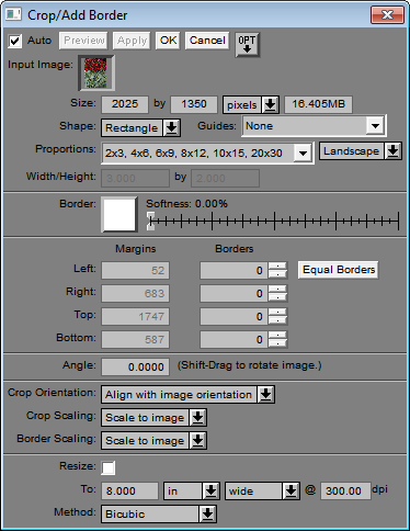

I'm not sure if this is related: in a Crop/Add Border widget, if the proportions are fixed, and there is a Break point set on this widget, if the training image is e.g. horizontal and the next one is vertical, the cropping rectangle properly changes orientation. But as soon as I touch this rectangle to resize it, it changes to the orientation of the training image back to whatever it was for the training image.

This does not happen when I try it -- the crop rectangle is stable. I am using the following settings: Align crop to image orientation; Scale Crop Rectangle and Scale Borders. Since crop has many other settings a well, perhaps you can send me a screen shot of your crop dialog.
Re: Cropping an Image
Screenshot attached. What happens is that when the image orientation changes, so does the crop orientation, until you touch it. Maybe there is something else that I'm doing wrong...
Can confirm it here as Maciej describes it.
Workflow containing of Crop/AddBorder Widget with Breakpoint and a Save Widget.
Images in Landscape and Portrait orientation.
At the Training image (Portrait orientation) the parameters are set to a fixed aspect ratio, Crop Orientation: Align with image orientation.
When coming to a image with other orienation then the training image during running the workflow the crop rectagle is displayed correctly first ( Landscape oriented on a Landscape oriented image) but jumps to the Portrait orientation of the Training image as soon the corp rectangle is resized.
Thank you for posting the screen shot.
The reason the rectangle realigns is that you have chosen Landscape under proportions. This choice supercedes the 'align with image orientation' choice. (The choices are incompatible, so one or the other has to take precedence.)
Currently there is no way to set definite proportions and make them align with the image orientation. The workaround would be to process landscape and portrait images separately. This can be done by selecting images that you want cropped to the selected orientation and then applying the work flow to 'Selected Images' in one operation. Then in a second operation, resetting the orientation in 'Proportions' and applying the workflow to the rest of the images. (There is no need to make a selection for the second operation, since the images already processed will be checkmarked and bypassed.)
Note that if you are using arbitrary proportions, the rectangle does automatically align with image orientation if that choice is made.
I should add that there is a way to edit both landscape and portrait images in one stream.
In the training image, set the 'Proportions' orientation to whichever orientation is the most common.
Then during processing, change the orientation if necessary during breakpoint processing.
You can use either this method or the one in my prvious message -- depending on whichever is simpler in your case.
Thanks Kiril,
Would it make sense, or be technically possible, to add possibility of automatically choosing vertical/horizontal images in a workflow, rather then selecting them by hand?
