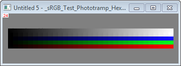

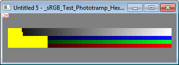

Trying to understand it better, I set shadow blocking threshold to pixel value=20 and run it on a test image that consist of 33 wedges - gray as well as a single R,G,B saturated colour (with a smooth gray gradient on top), each differing by 8 pixel value, to see what happens:
It seems to me that for fully saturated dark primary colours (which probably rarely happen in nature), the shadow clipping based on average will clip some more pixels than the straight HSV-V would (you could use Readout tool to see what clips). Neutral gray clips at V=20, as expected, but R,G,B saturated patches clip at 60 (since the other two channels are zero, the average is 20).
