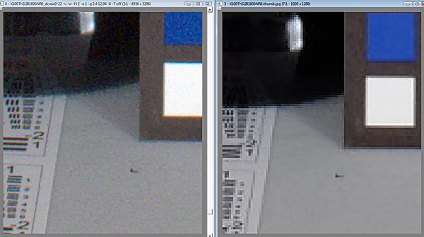

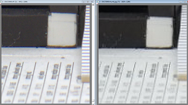

Here are two illustrations of X-Trans RAF file dcraw9.22 -v -w -H2 -o1 -g2.4-12.92 -6 -T conversions shown on the left and on the right is their reduced sized embedded jpegs zoomed to a comparable image size for illustration...
First... ...Fuji X-Pro1...
Second... ...Fuji X100T...
For both illustrations note particularly the red and green fringes at major edges for the raw conversion and that this is greatly reduced in the associated jpeg files as well as the interpolation artifacts.
Utilizing dcraw's provisions for Chromatic Aberration reduction, Wavelet Noise reduction, and Median Blurring to reduce color noise will generally add saw-tooth like artifacts to the major edges... ...so the red/green fringing and interpolation artifact reduction will have to occur in post-dcraw algorithms in a third party conversion/editor software workflow on the dcraw conversion tiffs...
...this then becomes a special case for PWP's Raw Dialog for X-Trans sensor conversions as it is based upon dcraw raw conversions... ...the insufficiency perhaps is not with the PWP algorithms but perhaps with dcraw's upon which PWP's Raw Dialog and transformations are based...
