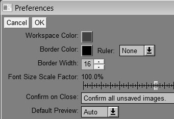

Am I the only one with this problem?
here is an example, comparing PWP with other apps (click for a 100% version).
Note, LibreOffice also has this Problem, but most apps don't.
cheers
afx
