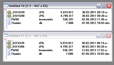

I thought it was a singular issue with a maybe corrupted file, but today I had the same problems, with all folders i have tried.
Opening a folder in browser updates the browser infromation, even when a PW60.browseinfo file already exists in that folder.
The bottom window shows the file before opening in PWP, the upper the file after opening the folder and re-. reading the info.
They are the same size exactly and the images were not modified in any way.

Re: Browesinfo file issue - agaian
Did daylight savings time just start in Germany?

Yes Jonathan, it did start on Sunday, and it was the first time today I worked with PWP since then.

It would have to be a time zone change to cause problems - Browse does not use the current time.

It could happen if you browse a folder that was in a different daylight savings time than currently in effect. So if you have not browsed a folder for some time, this problem could occur months later than the browse file was created.
