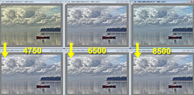

That's the way it seems to work for me using PWP 32 v6.0.9. I took an image and changed is white point color temperature to 4750, 6500, and 8500... then formed a Workflow with the first image [4750] as the training image and set the Color Balance widget to auto B/W and full extension... the result:
My Program File|Preferences|Remember Settings is set to "No" and as double insurance, I selected OPTions|Reset when making the Color Balance widget settings before clicking its OK.
