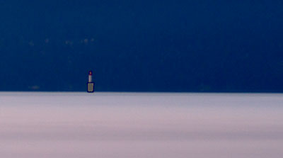

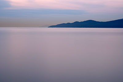

Another issue - I decided to only set the highlight end to 100% and left the shadow end at 31.8%. Once complete, I happened to notice a strange tone in the same area of the pilings that I had been using the Readout Tool. It was initially black, but changed to a strange brown in the finished image. As I thought it was a bug/problem related to the use of the Readout Tool, I closed the initial image, closed and re-opened PWP and did the same Transform (only extending the highlight to 100%) without using the Readout, but the result was the same change in colour. The even weirder thing is the change took place in the dark end, not the highlight end.
I have attached two images (if everything works out, I have not tried this before). One is the reduced full size image, to give you an idea of the size relationship of the pilings and the second is a crop of the pilings with the strange colour. Although the original is 16 bit Adobe RGB TIFF, these two are JPEGs.

However, your reference to taking black pixels and going from 0 to 31% confuses me, because I did not change the dark end of the image, all I did was leave the 31.8% as it was and moved the highlight end slider from 98.4% to 100%. The result was those black pixels, which were apparently ignored in Levels and Colour, being changed to a lighter, brownish colour, as in the cropped image in the attachment, which does not seem logical.

Levels and Color applies a curve that sets the dynamic range of the output image to exactly what you ask for - namely 31% to 100%, so any pixels darker than what it detects as the black point are lightened. Normally this is not an issue, but if it picks the wrong black or white point there can be artifacts.

Because of the way Levels and Color works, the dark end is being increased by 31%. Levels and Color works by computing a brightness curve automatically and then applying it to the image. The curve is horizontal from 0 to the black point it determines automatically so everything below the black point it discovers is lightened. Otherwise there would be a big kink in the curve which could produce other shadow artifacts. If you create your own curve you can avoid all the pitfalls of automatic black and white point detection.
