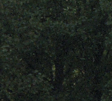

AHD and VNG RAW interpolations can produce artificts, especially visible in shadows and when original RAW file is noisy. AHD produces a 'maze' or 'rods' like artifacts, while VNG is more like salt and pepper, lonely single pixel high-amplitude noise.
Since they have pretty unique character, I started thinking of a way of removing them, without obliterating details, before sharpening, but I can't figure out a good technique. Median, Blurs or USM with thresholds don't quite cut it, because these artifacts have higher amplitude than details, which will be removed first. AS speck removal is probably the closest to what I want, but it's still hard to separate these artifacts from details. Are there other techniques?

- VNG (2:1)
- VNG-noise.jpg (28.49 KiB) Viewed 7621 times
- AHD (2:1)
- AHD-noise.jpg (28.34 KiB) Viewed 7622 times

You might try experimenting with DCoffin's 'dcraw' options:
If you need a Windows 'command line' "dcraw v9.10" executable, I can make it available. It is only 324KB... but if you have SNS-HDR Lite/Home/Pro v1.4.2 installed... it is located in the their 'Program Files' folder.INTERPOLATION OPTIONS
-f
Interpolate RGB as four colors. Use this if the output shows false 2x2 meshes with VNG or mazes with AHD.
-m number_of_passes
After interpolation, clean up color artifacts by repeatedly applying a 3x3 median filter to the R-G and B-G channels.

If you note the progress bar, raw already includes an artifact reduction step.
Re: AHD and VNG interpolation artifacts
True. Perhaps it is the number of passes of the median that would have to be increased to remove the artifacts in this example... I'll experiment with dcraw and report. Did others try it before?
