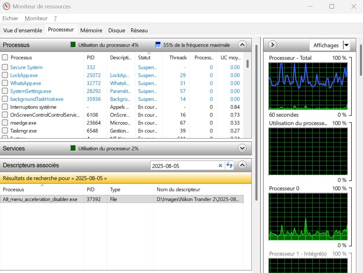

I got this:
2025-09-18 Alt_menu_acceleration_disabler.jpg (163.2 KiB) Viewed 11480 times
It seems that Alt_menu_acceleration_disabler is the program holding up the file.
After ending the process, I have been able to rename the file.

Interesting --- I can't think of any reason AltMenuDisabler would open an image file or folder.
I was getting this error occasionally a while ago but not recently. I think it may also be an issue with Windows Explorer itself which was likely fixed by an OS update.
