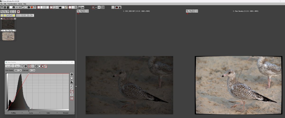

problem : raw develop strange lens correction

jsachs wrote: September 4th, 2025, 9:59 am I think the problem may have to do with the installer leaving some old files around when installing the new lens profile data. One last thing to try -- delete both the Lens Profile and the LensFun/db folders and then re-install PWP.
Also uninstalled PWP, rebooted before re-installing.
Problem persists
Re: problem : raw develop strange lens correction
Very strange -- can you send me a copy of the file: NIKKOR Z 24-200mm f_4-6.3 VR.lens profile
You should be able to just attach it to an email.
Thanks
On the assumption that the 526 installer was installing old files, I have uploaded a version 527 which hopefully will fix the problem. Again, delete the two settings folders before installing and let me know if this works.
I think this may have been caused by your being in a locale which uses commas instead of periods as a decimal point. Normally I correct for this and always use periods within saved files for interoperability, but I may have missed a few cases. I am posting a new version of the PWP executable for you to try at:
https://www.dl-c.com//Documents/Picture ... 20Test.zip
You will need to delete the lens profile before running it.
Posts: 746
jsachs wrote: September 4th, 2025, 12:58 pm I think this may have been caused by your being in a locale which uses commas instead of periods as a decimal point. Normally I correct for this and always use periods within saved files for interoperability, but I may have missed a few cases. I am posting a new version of the PWP executable for you to try at:
Everything looks good to me now.
Many thanks !
2025-09-04 PWP 8.0.228 lens profile OK.jpg (62.83 KiB) Viewed 47514 times
