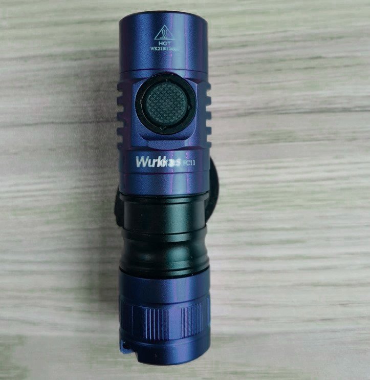

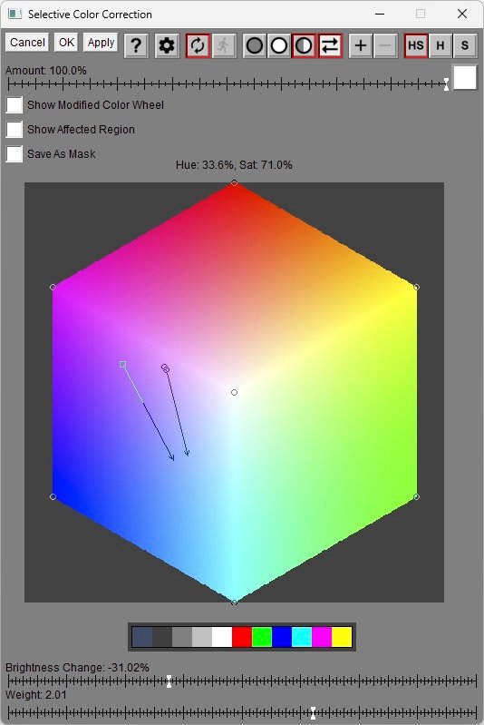

I had the best results with Selective Color Correction - could be cleaned up a little but you should get the idea:
scc v1.jpg (53.91 KiB) Viewed 2610 times
scc result.jpg (70.3 KiB) Viewed 2610 times
I also tried Color Curves and did a hue shift to magenta and darkened the image.
Using a mask for the flashlight would make it easier to adjust since you could alter the brightness and shift all the hues and only the masked area would be affected.

Cheers for that. I used the Selective Colour Correction with just one vector and with the right weight it can capture most of the colour to correct and then darken it too. I wonder why I was spectacularly unsuccessful with Remap? I also found that matching, even approximately, the target colour is a challenge. I tried using Palette tool and guess the position of the hue/saturation on the colour wheel but found it quite hard.

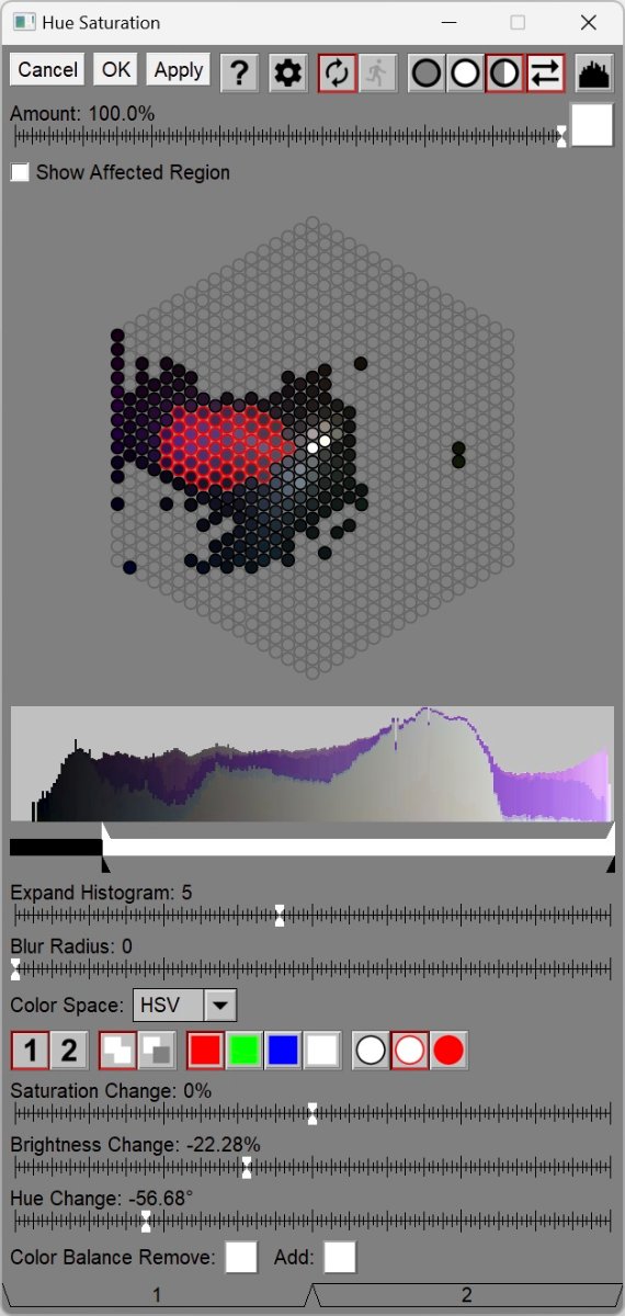

Re: Replacing a narrow range of hues with a different one
Remap is specific to a particular RGB color while Selective Color Correction is specific to a hue/saturation combination, ignoring brightness.
The Hue-Saturation transformation works even better:
HueSat v1.jpg (109.48 KiB) Viewed 2589 times

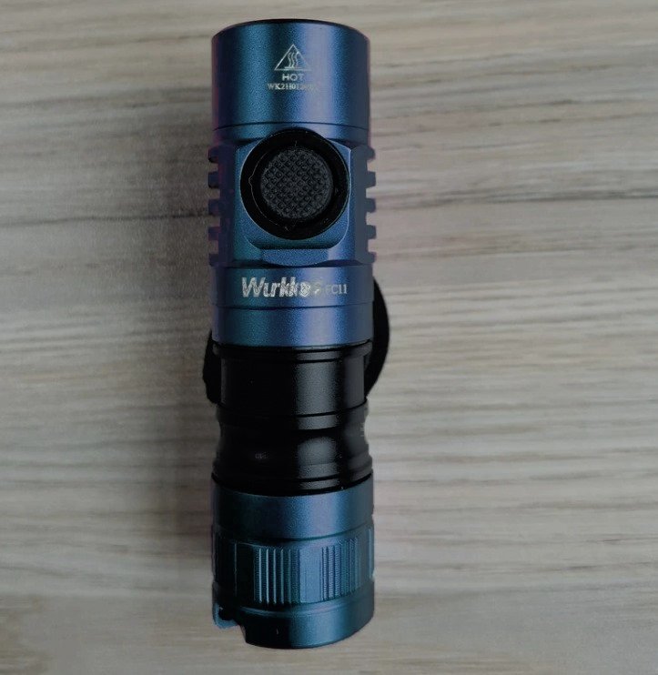

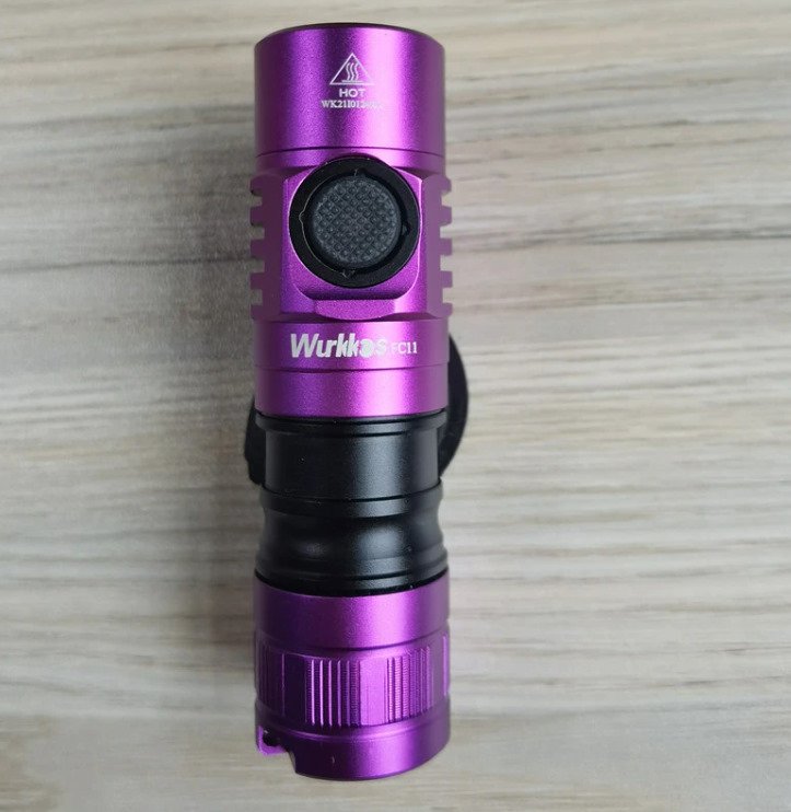

One method is to work with hue curves :
For magenta to blue :
Wurkkos blue 2.jpg.script
(4.5 KiB) Downloaded 273 times
Similar for blue to magenta :
Wurkkos Magenta 2.jpg (45.31 KiB) Viewed 2575 times
Wurkkos blue 2.jpg (65.13 KiB) Viewed 2575 times
