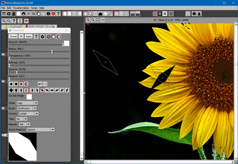

When cloning with the square or diamond shapes and using any angle other than zero degrees, while the white outlines of the input and (intended) output are correct, the actual output is at an angle of -x degrees when it should be +x degrees.

It seems OK here -- can you post an example?

Just cloned from the black area into the yellow petal area.

The problem only shows up depending on the relative positions on the source and target points. Fixed for next release.
