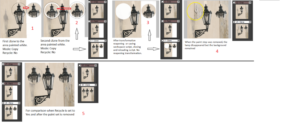

It is not just when you re-open the transformation. If you save the workspace script, close it and reload it, you can see it already in the thumbnail - no need to re-open the transformation. It Iooks as if it is not saved in the script at all.
In an attempt to better understand the difference I created this scenario:
I painted part of an image white.
Image 1
Recycle = No
First clone made to the painted area.
Image 2
Recycle = No
Cloned back including a white background circle. Clicked OK.
Image 3
Recycle = No
Reopening the transformation (or saving, closing, reloading the workspace script, without reopening the transformation.)
The lamp was removed but the white background from the painting step was preserved.
What is the right behaviour here?
Image 4
Recycle = No
When the painting step was removed, the white background replaced with the real background before it was painted white.
Image 5
Recycle set to Yes, paint step removed.
This time both the lamp and the narrow background circle are preseerved.
Image 1
Recycle = No
Image 2
Recycle = No
Image 3
Recycle = No
Image 4
Recycle = No
Image 5
