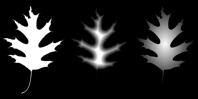

The effect of using an oval gradient is somewhat different from negative feathering which softens a mask pixel in proportion to how close it is to an edge, so the softening follows the contours of the original mask.
To draw an oval gradient, you need to click and drag on the input image to define its location -- then you can adjust it by dragging control points.

Here is an example of the same mask, first with a negative feather radius and then with an oval gradient.

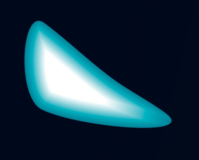

So far, I have tried resize smaller, negative feather, then enlarge to original size. I am attaching two images with the results. One is the initial attempt, and it looks pretty good, except for the upper and lower "corners", where it (visually) appears the negative feather does not occur right at the apex (if that's the proper term) of the corner, resulting in the "spike" leading to both corners. If it would look the same as the third corner mid-left side, it would be perfect.
To try and correct those spikes, I did another image where I just used a straight gradient mask in the lower corner (emanating from the apex towards the center of the shape), then composited that with the result as described above, using Darken as the blend mode. However, as can be seen, it appears to have caused two parallel spikes. Not sure why that happens.
So far, though, it looks promising, and have yet to examine the other suggested methods.

The spikes are a well-known optical illusion.
In the meantime I have increased the maximum feather width to 1000 for the next release.
