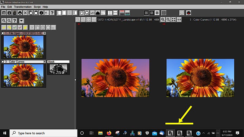

Heh! Ha! the laugh is on me... ...perhaps a note in Help for those whose Win10 option is to "Automatically Hide the Task Bar when in Desktop mode":
Screenshot (16) v1.jpg (79.57 KiB) Viewed 5165 times
Thank you for the Hint/Refernce to combine mask script files in a Mask Dialog Box session.

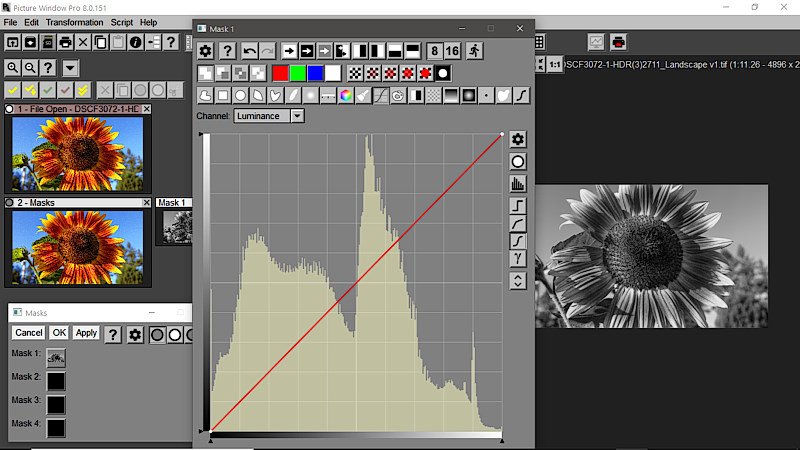

I was not trying to do anything special... ...just create an illustration. Mask 1 is simply the Luminance channel of the File Open image:
Screenshot (17) v1.jpg (88.29 KiB) Viewed 5143 times
I will sometimes use this as a basis to isolate subsequent Luminance tone ranges and perhaps adjust them to contrast preference with the Mask Brightness Curve.
