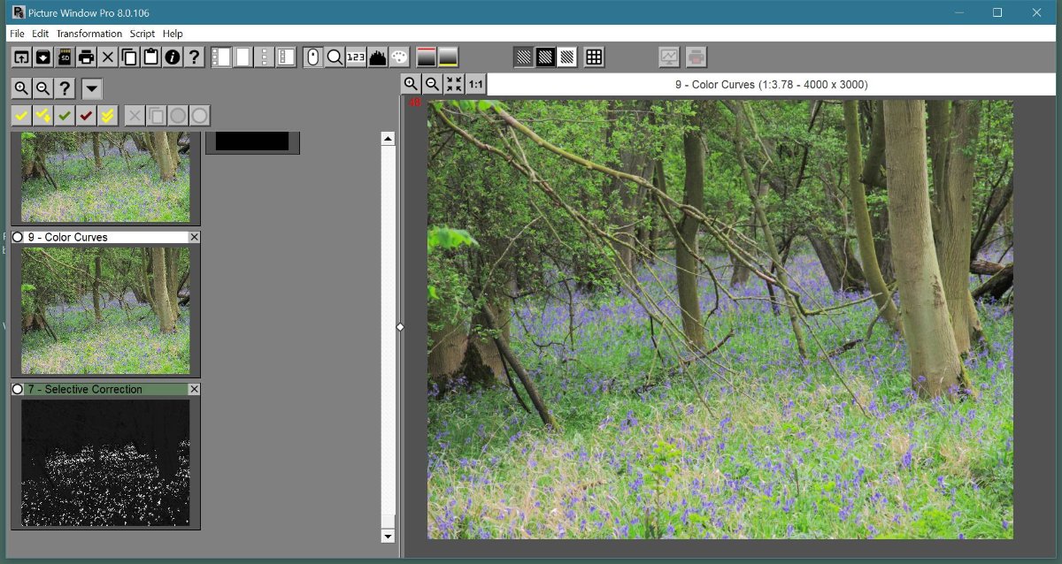

In the Selective Correction dialog I saved a mask. It appears in the image browser, labelled Selective Correction, in the same column as the various stages of the photo I'm processing. I'd like to use it as a mask in another transformation. But I can't see how.
Clicking the white square in the Color Curves dialog does not give that SelCorr. mask as an option. I read through the Help on Masks and didn't find what I wanted.
I'm using v8.0.106, and I'm not an expert user: I use transformations, as I've been doing for many years, but I don't use automated/batch processing, and I don't normally save all the processing information.

What I was trying to do was create a mask, not using the mask dialog, but using "Save As Mask" in the Selective Color Correction dialog to pick a colour and generate a mask from that. It does save a black and white image which looks like a mask, as you see from the screenshot. But it shows up in the column of images, not in the second column which currently contains blank masks.
I've not found a way of using that BW image as a mask. It is never offered to me when I click the Amount box in a transformation for an image downstream of the SCC transformation. (Meanwhile I've done more or less what I wanted to do, by a different method.)

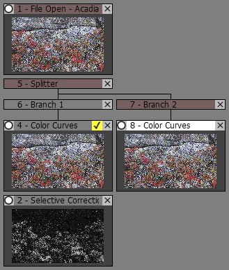

1) Add a splitter above Color Curves and make a copy of the Color Curves transformation in the empty side branch. You can select the mask in this copy and then proceed from there. This works because, by analyzing the dependencies in the workspace, Picture Window computes the left branch before the right branch and the left Color Curves does not depend on the right one, just on the images above it.
