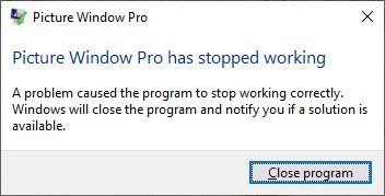

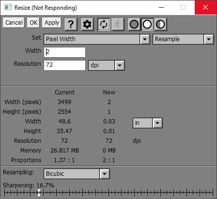

Using Picture Window Pro 8.0.103
Resizing an image width from say 3000 pixels to 2400. If I just type the "2" of the 2400 and wait too long to type the rest, it starts calculating the new image with a width of 2 pixels apparently and crashes, see attachments (using two monitors).
PWP 8.0.103 resize crash.jpg (33.45 KiB) Viewed 2467 times
PWP 8.0.103 resize crash 02.jpg (16.59 KiB) Viewed 2467 times
