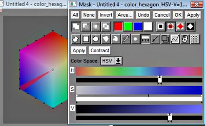

For example, I changed the normal default Value from 100 to 75% for a Color Dialog Hexagon image and set the Color Range for the Mask Tool to mask a narrow Blue Hue [67] range, to include all Saturations at a narrow Value of 75...
If the 75% toned Color Hexagon were a photo, the mask would map all pixels within a narrow range centered at Hue=67 [Blue]; Saturations=0 to 100; and a narrow range centered at Value=75.

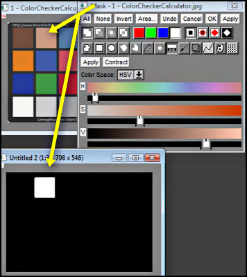

Mask Tool - Color Range can be used to pick a 'narrow' range of colors/tones centered about a preference 'solid' color/tone... ...for example, the following illustration has color range settings to map the "light skin" square of the Macbeth ColorChecker chart...
