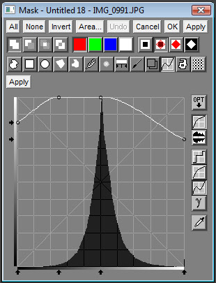

Update: …Use an interactive Mask Tool-Brightness Curve to essentially duplicate the suggested Step …4) Brightness Curve of the resulting Step …3) image…
As noted in Consideration …3) this curve profiles the dark to light edge contrast gradients. An interactive mask will allow with a None or Undo of the Mask Tool to change the dark to light biasing while monitoring Preview during the Step …5) Composite-Hard Light blend transformation to further your preferences to be image specific.

...4) Click on the resulting 3) image version and open the Mask Tool – Brightness Curve; lower left Apply Add a Smooth curve = [0,85], [25,100], [50,100], [100,75]; and leave the Mask Tool ‘active’ on the resulting 3) image…
...5) Click on the starting image and open Composite-Hard Light where Input=starting image at Amount=67 or preference and Overlay=the resulting 3) image with the …4) mask white Amount=100 and …4) mask black Amount=0; click OK… …creating the Medium Detail Luminance Local Contrast Enhancement image…

Example… if the suggested Step …4) mask curve still results in objectionable white half edge halos, one could: click Mask Tool None; relocate the [100,75] control point vertically downward to [100,65]; then lower-left Apply Add the revised curve; and watch for the change to occur as Preview updates…
…perhaps with a little bit of thought you will be able to visualize the near equivalency of the suggested Mask curve when applied to a High Pass image histogram distribution to the originally suggested Brightness Curve transformation of the USM sharpened High Pass image version… …Hint: the suggested Mask curve behaves in the same manner as does the Density Masks of the HDR/Stack Images transform.
