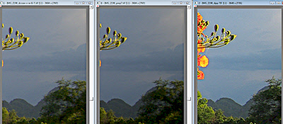

...With Canon 350D CR2 files, I can get one to one registration with a linear offset margin crop of dcraw, SNS-HDR, and PWP conversion tiffs with a DPP conversion tiff... ...but...
...When attempting to do the same with a Canon S95 CR2 file, there is one to one registration between dcraw, SNS-HDR, and PWP conversion tiffs... ...but the DPP conversion tiff apparantly also includes proprietary lens abberation corrections that not only eliminates the RAW edges ["actual pixels" minus "effective pixels"] but also corrects for lens distortions making it essentially impossible to easily one to one register the non-DPP tiffs...
...Maciej... perhaps the lack of DPP "proprietary lens corrections" may be also a contributing factor for the chroma bloom you have been experiencing with the S95's CR2 files that are converted with non-DPP software...
Illustration: ...left-dcraw-v-w-6-T; ...center-PWP7basic; ...right-DPPdefault
Notice the apparant 'close up' image area of the DPP image area [lens distortion corrections, perhaps] when compared to corresponding the dcraw and PWP image areas...
