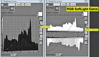

Composite-Soft Light and Composite-Hard Light filtering where the Input equals the Overlay image really works best for those images whose histograms are single peaked at the 50% tone and have ‘bell’ shaped distributions with small, isolated image areas that are deep shadows and high highlights… …for example: facial portraits where the main visual element (head) occupies 75% of the available pixel area, the remaining being background.
Here, the increased mid-tone contrasts do not seemingly result in blocked, clipped deep shadows or high highlights because of their small, isolated image areas and small histogram contributions.
…but what of images with multi-peak and multi-minimum histogram distribution and significant deep shadow/high highlight image areas such as nature landscapes?...
In this case, one could use a RGB Brightness Curve transform with a ‘S’-contrast curve that mimics the Soft Light or Hard Light filter of the Composite transform… …adjusting its control points to image specific histogram peaks, minimums, and mid-tones… …also adjusting the curve for the deep shadows and/or high highlights to limit contrast losses that would show as blocking, clipping, loss of detail as the image’s mid-tone [with perhaps a preference offset from a 50% tone] contrasts are increased…
…what if you could observe the histogram changes in real time as well?...
The RGB_SoftLlight.crv in ‘plain’ text:
Curve 1.0
npts 7
style spline
histexpand 0
point 0 0 0
point 1 32 11
point 2 64 40
point 3 128 128
point 4 191 215
point 5 223 244
point 6 255 255
end
The RGB_HardLight.crv in ‘plain’ text:
Curve 1.0
npts 7
style spline
histexpand 0
point 0 0 0
point 1 32 8
point 2 64 32
point 3 128 128
point 4 191 223
point 5 223 247
point 6 255 255
end

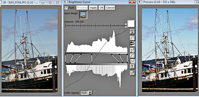

1) Copy/paste the curve file text using Notepad; name; and ‘save as’ *.crv.
2) Open or click on a ‘starting image’… …the starting image may have previously been color balanced to have full dynamic range with color casts removed from its black and white points [the default ColorBlance transform settings].
3) Open the Brightness Curve transform selecting the RGB color space.
4) Load either the SoftLight or HardLight curve.
5) Switch transform from Show Curve to Show Histogram.
6) Adjust control points to preference specific for the Input image.
7) Click Apply or OK…
Soft Light RGB Brightness Curve illustrations:…
The Curve…
RGB SoftLight BrightnessCurve_show_Curve_Histogram.jpg (48.51 KiB) Viewed 4809 times
The Adjusted Curve with before (top)-after (bottom) histograms…
RGB SoftLight BrightnessCurve_adjusted.jpg (48.13 KiB) Viewed 4807 times
Comment: My tests indicate that the suggested RGB curves will essentially duplicate Composite-SoftLight or HardLight filtering an image with itself at 100% Amount to within a 1 to 3% Absolute Difference.
