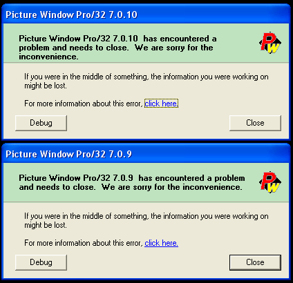

by ICampos
No, I do get the usual error happened window, so it's reasonably well behaved, not a hard crash pure and simple.
My XP SP3 is EN-US and is fully up-to-date, including this month's updates as released by MS on patch tuesday.
I've done some more tests and attached the resulting logs, as a .7z file
The relevant file (pw70.exe) has:
For version 7.0.10.0
8,299,520 bytes
CRC32: 3019A565
MD5: 77BC8FD7E455E6ABAE59E69CC285BD4C
For version 7.0.9.0
8,291,840 bytes
CRC32: D946BCF8
MD5: 6152D0AED6BAC627969ED053107BDB23
Both crash exactly in the same way.
Another possibility for the origin of the problem is if PW70.EXE relies on SSE2 instructions, while PW60.EXE does not.
The Athlon XP (Barton) is not SSE2 capable, although it processes SSE and MMX.
