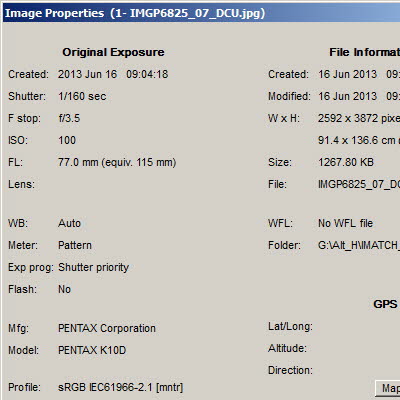

1st example:
I extracted the embedded jpg from a Pentax *.pef file using the Pentax utility.
I would expect to see the the original time in PWP, but I don't.
So I consider this as a bug.
I attach a screenshot and the output from exitftool for the jpg.
screenshot
screenshot
Since only 3 attachements are maximum, I will add the output from exittool in the first reply.

ksinkel
Posts: 594
Re: Metadata - living hell ?
Post by ksinkel »
If you have a file whose exif create date is shown incorrectly, please send me the file and I will take a look at it. You can email it to support@dl-c.com. If it is large, please use one of the file transfer services.
Posts: 247
email sent
