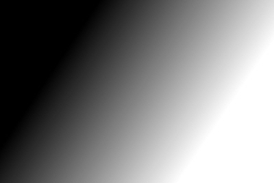

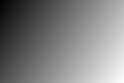

(1) click or open the starting image...
(2) open the Gradient transform, creating a preference angled [could also be the default horizontal or vertical] black to white linear Fill gradient. Click OK to create the 8bit BW gradient image. For example: black at the image's upper left corner and white at the lower right corner...
step(2) gradient image.jpg (16.03 KiB) Viewed 8570 times

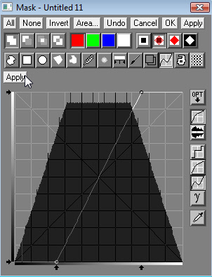

(3) open the Mask Tool - Brightness Curve and apply a preference start and stop diagonal curve to the gradient image. Leave the Mask Tool 'active'. For example: a mask BrokenLine curve = 0,0; 25,0; 75,100; 100;100 will move the black point from its corner 25% of the way and the same for the white point.
Mask Tool BrokenLine curve.jpg (45.85 KiB) Viewed 8573 times
step(3) active mask.jpg (16.32 KiB) Viewed 8567 times
(4) click on the starting image and open a preference transform selecting the step(3) mask. As the step(3) mask is 'active', its black and white points can be changed with a Mask Tool Undo and a re-APPLY with a different BrokenLine curve. Transform Mask Amount black and white sliders can also used to a preference... for full effect leave mask black at 0 and mask white at 100.
