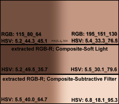

In the following illustration, the dark/light sRGB MacBeth skin colors/tones were Composite-Soft Light and Composite-Subtractive Filter with their extracted RGB-R channel as the Overlay... ...the resulting HSV parameters are indicated:
Whether this is an improvment or not depends on ones goals...
The illustrated changes in the HSV parameters can also be accomplished with: (1) HSV-V and HSV-S curves using Color Curves transform or (2) changes of hue/saturation/tone of selected skin color/tone control points in the Color Correct transform... ...perhaps accompanied with a skin color/tone range mask to ensure limiting changes to skin image areas.
