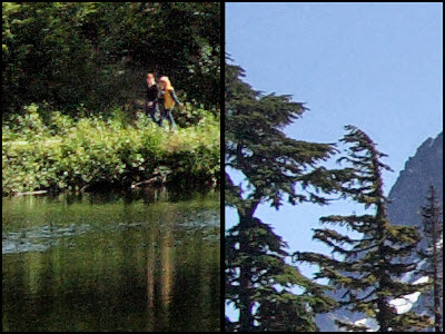

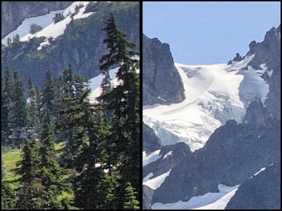

Below are 1:1 resolution, 200x300 pixel image area crops, unchanged accept using jpeg compression so that the file size is 50KB or less, of the resulting Workflow image. The starting file is a Canon 350D CR2 file, 3456x2304 pixels, recorded with 'good' photography technique: tripod; f11 to reduce lens defraction; exposure checks to ensure the recorded data is within the sensor's range; ISO 100 for lowest noise; exposure not right shifted to retain low contrast cloud/snow detail...
Additional edits depending upon Compositional Crop locations that the resulting Workflow image might need, would be upper left and right corner light falloff and lens distortion or warp correction of the inward leaning left and right side trees.
