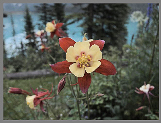

I recently have started using an Olympus XZ-1 and am trying to process a picture of a flower I took in Canada. I originally used the Olympus Viewer to download and convert the raw image. The picture looked extremely good. I then tried to convert the raw file using Picture Window Pro. The results were extremely disappointing. The image was mostly washed out with very dull colors. The 2 pictures can be seen on Picasa. Hopefully I've correctly inserted the Picasa web site where the pictures can be seen.
https://picasaweb.google.com/mbbondy/CanmoreAugust2011#
If not , the URL can be cut and pasted into your browser of choice.
At any rate, does anyone have any idea what I'm doing wrong in Picture Window Pro? Thx in advance.

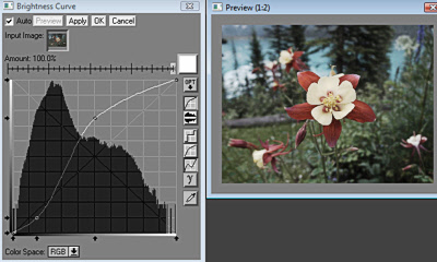

(3) The Picasa posted PWP conversion image would be greatly improved with a subsequent RGB Brightness Curve transform with a Smooth curve = [0,0], [15,10], [50,75], [100,100]; Amount = 100.
or possibly a Color Curves transform with Amount = 100; HSV-V Smooth curve = [0,0], [15,10], [50,75], [100,100]; and HSV-S Smooth curve = [0,0], [8,10], [50,75], [100,100].

Thx for the response. At the risk of showing my ignorance, I figured out that I was mistakenly using Nikon D60 settings (my other camera) instead of the Olympus. OK, I changed that and still the picture looks very bland, washed out. Now, Gamma=2.20, Contrast-Medium Expansion, Camera Profile=none, Whitepoint=Camera WB, Output Color Space=sRGB, preferred Interpolation=AHD I did try changing the Color transformation curves and that helped. However, it seems strange that the Olympus software did such a great job automatically and PWP requires a lot of "help". I wonder if the XZ-1 isn't in it's library yet.

Personally, I exit the RAW Dialog with images appearing much like the one you obtained and precede to use the a RGB BrightnessCurve or ColorCurves transform to set white/black points, midtone brightness/contrast, and color with initial curves the same as those suggested... ...then move their control points slightly to obtain a preference tone/color image version.
The curves are my personal preference for making adjustments rather than the sliders of the RAW Dialog or Levels&Color transform.
