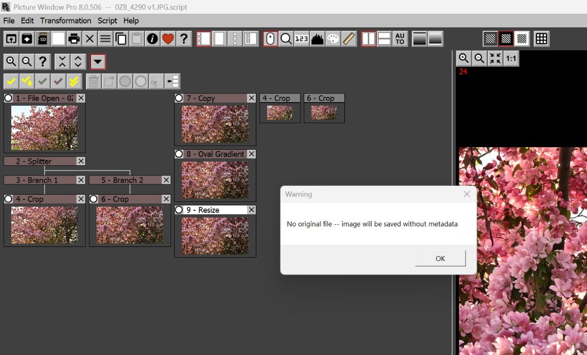

Screenshot and script attached

Posts: 4900
Re: suggestion : Copy transformation and metadata
Currently this only works if Copy has a single active input. A similar issue exists with other top-level transformations such as Layout or Stack Images that may have multiple inputs. With some work, Copy could be treated as a special case since it only has one input at a time, but it does not work that way now.
