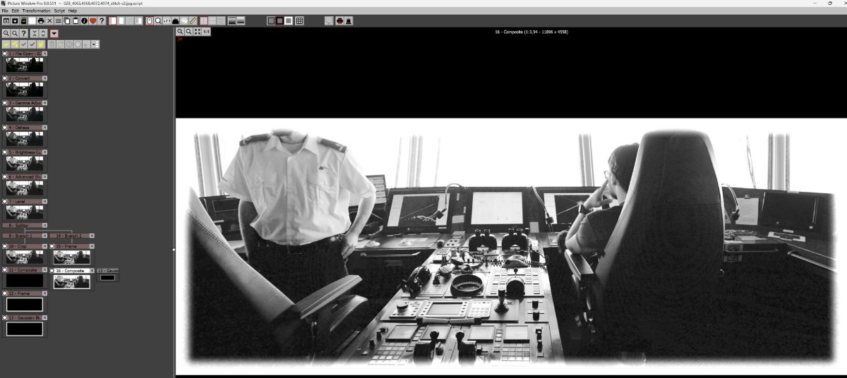

Thanks for the continuum oval-rectangle oval gradient. However, as you pointed out it cannot provide constant width gradient along the shape.
I tried to obtain the desired effect using a combination of Frame, Gaussian blur, Crop transformations, but if is a convoluted convoluted solution.
Is there a simpler way to get the desired effect ?
2025-05-07 gradient along rectangle - sort of v1.jpg (97.02 KiB) Viewed 2298 times
Script is attached
Re: Feature request : Oval and rectangular gradients
Posted: May 7th, 2025, 6:07 pm
The Mask Feather tool does this, although in a limited fashion since you have to start with a solid rectangle or ellipse and there is no Color Line control to vary the gradient.
So does Add Border if you use the Softness slider, which looks like it does exactly what you are trying to do in the sample image.

Thanks for the Add border suggestion, I had not thought about it.
