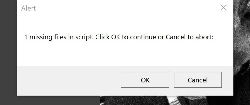

Any suggestions as to how I cure this?
Screenshot 2025-02-17 213756.jpg (29.72 KiB) Viewed 3425 times
It happens each time I open my saved Script.

This is simply a warning that one or more of the files referenced by the script file does not exist. In this case it happens because you saved without image names. Just click OK to dismiss the warning -- then it will ask you to specify a file to open. Once you specify a file, it opens it and then proceeds to process the rest of the transformations in the script.
I see that this message is confusing, so for the next release I am suppressing the warning if the script was saved without image names.

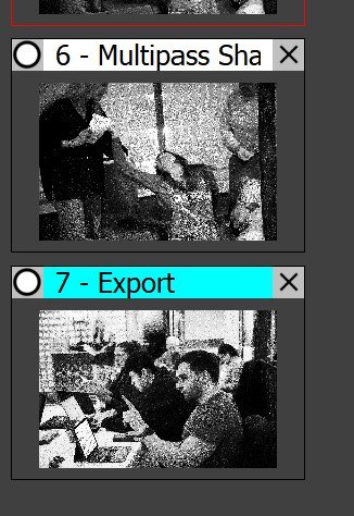

Nearly there!

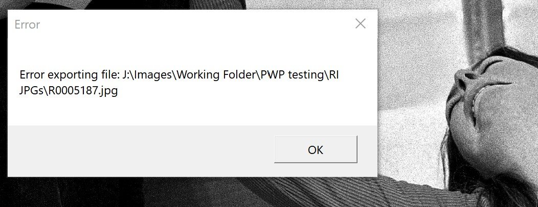

I seem to have an error in my Export transformation. I get the error message.

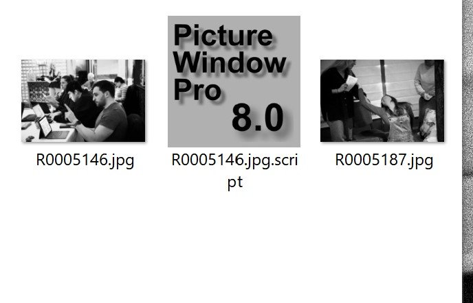

The first image in my batch created a script but the second one produced no script.

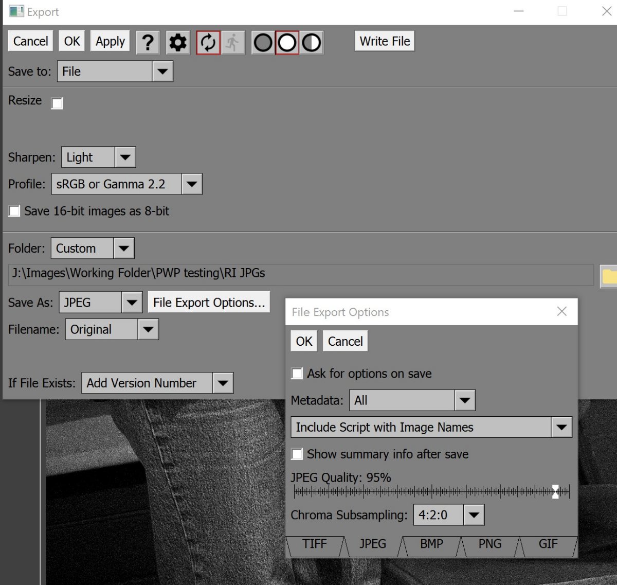

This is my Transformation.
Is the fact that there are two different files here a clue?
See next post.
Re: Loading a folder of RAWs and applying a script
Posted: February 18th, 2025, 10:28 am
by tonygamble
Is this a clue?
