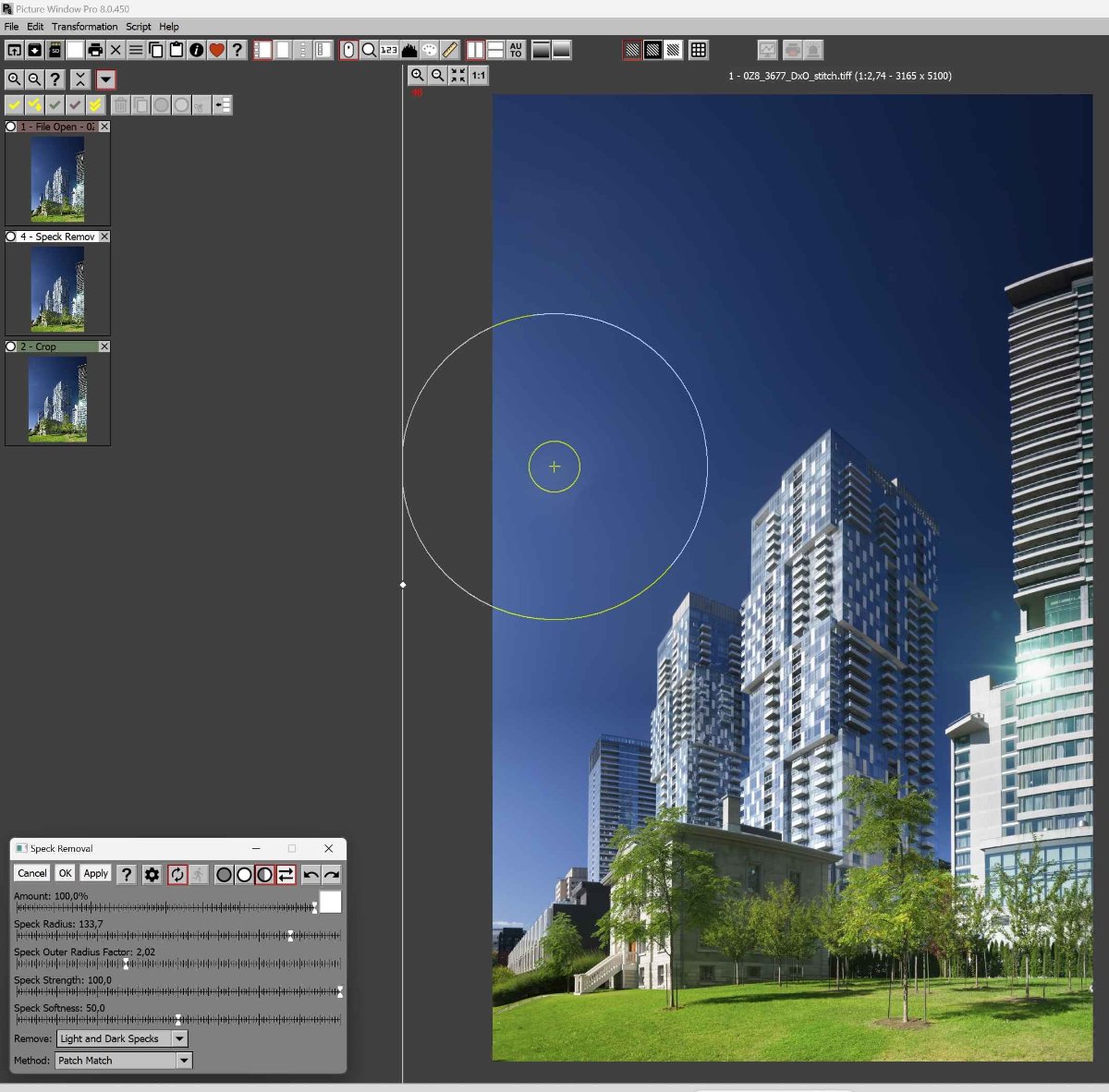

Scenario
  • Open tif 48-bits image file ( e.g. 3165 x 5100 pixels )
  • Invoke the Speck removal transform with a large radius
  • The GPU fan starts whirling
  • When user attempts to cancel the transformation using the dialog box, nothing happens for minutes
2024-09-29 PWP speck removal v4.jpg (214.32 KiB) Viewed 853 times
Re: Speck removal tool : PWP appears stalled with excessive CPU utilisation
The time goes up as the square of the radius. A while ago I fixed a bug that was making this run faster but not searching thoroughly.
