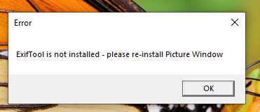

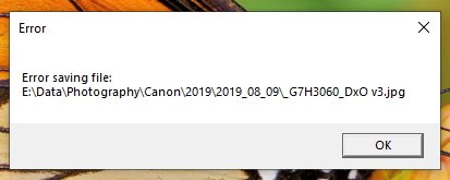

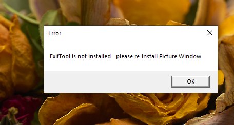

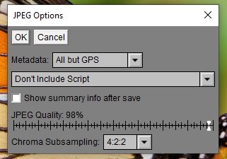

by jfoster
DId a full install. I am seeing the problem consistently - immediately after install, upon closing PWP and re-starting it, and after rebooting my system.
Here's the JPEG Options window showing the settings that I'm using:
And here's the two error messages that appear:
Re: Update Available - Version 8.0.442
Posted: August 5th, 2024, 5:15 pm
I think some minor changes I made may have fixed it since uninstall followed by install now seems to work OK. Will post an update shortly -- let me know if the problem persists.
