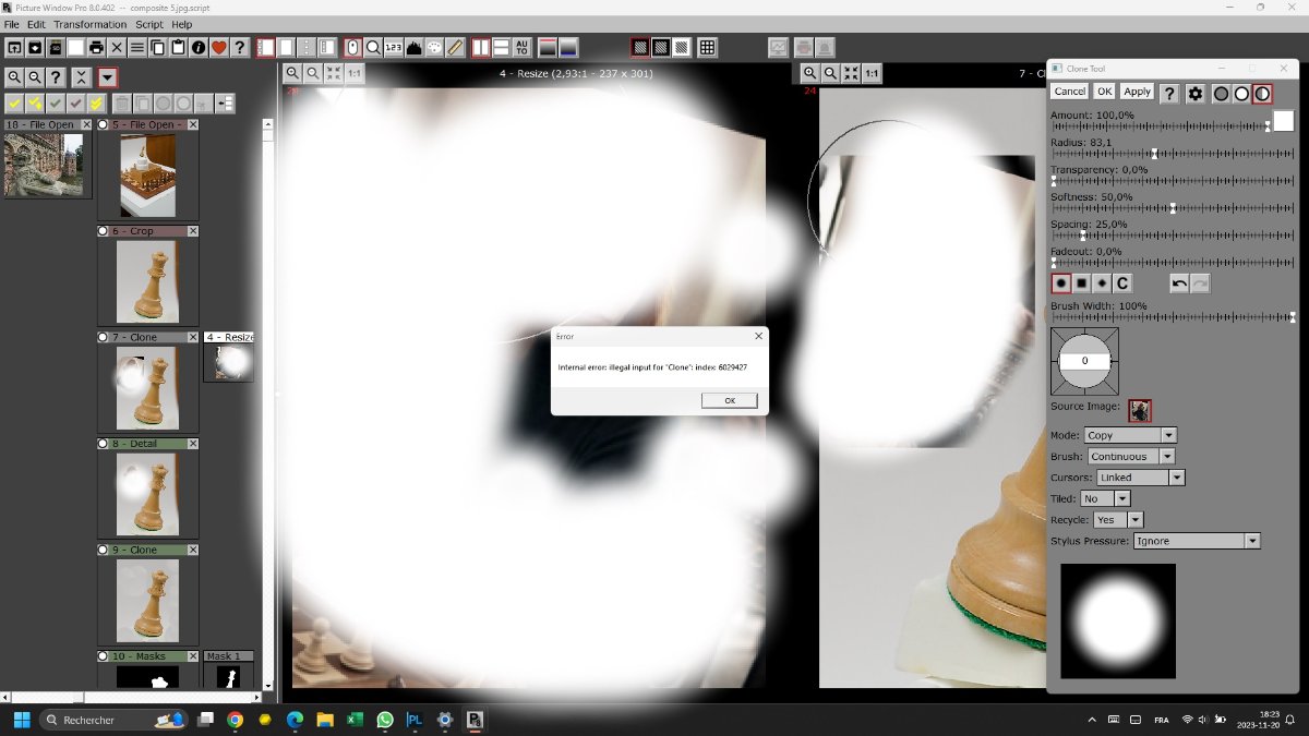

PWP reported an internal error during usage of the Clone tool
2023-11-20 PWP Clone tool Internal error Illegal input for Clone Index.jpg (103.32 KiB) Viewed 1512 times

My guess is that this is somehow related to the Source Image -- from the tiny thumbnail in the dialog box it looks like it is referring to some image other than the ones displayed in the image browser. Is it possible you closed this input image at some point? PWP should detect this and reset the Clone transformation. Let me know as much as possible about the scenario you were performing when you got the error. FOr example, had you just changed to a new Source Image, did the error occur when you re-opened a Clone transformation or in the middle of creating it? and anything else you can remember about what happened before you got the error.

A close script is attached -- it may not be identical, however.
I do not remember very well. I was making changes possibly in the photo resize transformation or in the cropping rectangle rotation angle.
