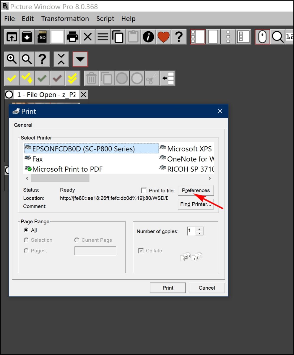

When I do Ctrl-P, a Windows printer dialog pops up. It pops up quickly, so you might want to look into your connection between PC and printer.
I must remember to click on the little Preferences button, which launches the printer dialog for my Epson P800, where I set sheet size, color management mode, etc.
PWP used to have a printer setup choice on the dropdown File menu. Now it is the setup described above. The main thing I've impressed on myself is, go slowly during the entire sequence of print choices. Specify the paper/printer profile. Double-check the placement preview, which sometimes leads me to go back and change 720 dpi to 360 dpi or vice versa.

Lilke Charles2 said, the contents and appearances of the windows that appear in the process of printing an image changed a few months ago. The first window that appears for me differs that what Charles2 sees. In mine, I can choose the printer, and then I must choose "more settings" to get to a printer-specific window where paper and resolution are chosen, and following this comes a PWP window allows setting the margins and which displays how the image fits on the paper.
