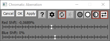

1. The amount values for red and blue shift cannot be inputted via keyboard, the sliders have to be used. The available settable values are quantized. Let us suppose that setting the slider of Red Shift: -0.0689% results in the otimal correction.

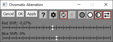

The transformation is run by clicking 'OK'. When the CA transformation window is fetched again from the menu and 'Settings/Reload Last Settings' is executed, a value of Red Shift: -0.07% is displayed, and when the settings are saved ('Save Settings As...'), the parameter 'amountr' has a value of 0.0007 (= 0.07%) in the "*.chromatic aberration" file. The displayed or stored value is imprecise, so one is not able to know whether the used value was 0.0689% or 0.0745%. I would like that 3 significant digits (0.0689%) are displayed, as if one sets the value.

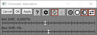

2. When the same CA transformation is executed in a script and a double click is executed on the "Chromatic Aberration" thumbnail in the image browser, the CA transformation window shows a value of Red Shift: -0.0007%. This value is obviously wrong.

For the next release, I have increased the degree of precision with which the slider values are saved and fixed the inconsistent value display.
