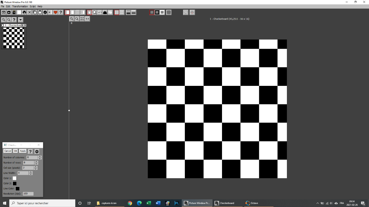

The checkerboard does not accept cell size 1 : when 1 is entered, it uses two instead.
2021-02-26 PWP8 checkerboard does not accept cell size 1.png (93.82 KiB) Viewed 3758 times

The minimum checkerboard cell size is 2. Picture Window does not handle 1x1 pixel images for various reasons, so setting the minimum cell size to 2 prevents this from happening, no matter what the number of rows and columns is set to.
The Resolution Chart test pattern has a section of 1x1 checkerboard which you could crop out if you really need it.

Hi Jonathan
Couldn't PWP8 checkerboard accept a cell size of 1, while disallowing a total image size of 1x1
Posts: 4883
Re: Test pattern checkerboard does not accept cell size 1
It could. Fixed for next release.
