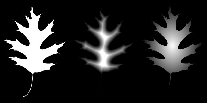

If you start with the spline mask, then switch to Overlap mode, and then draw the oval gradient, the oval gradient will be restricted to the region where the spline mask is defined.
To draw an oval gradient, you need to click and drag on the input image to define its location -- then you can adjust it by dragging control points.
The effect of using an oval gradient is somewhat different from negative feathering which softens a mask pixel in proportion to how close it is to an edge, so the softening follows the contours of the original mask.

Here is an example of the same mask, first with a negative feather radius and then with an oval gradient.
