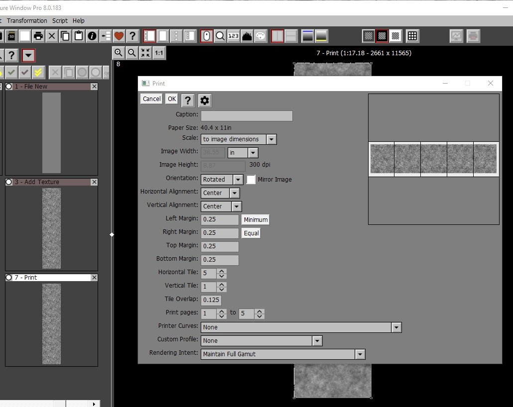

There do seem to be a couple of minor problems with the interface for tiled printing (which I have not used or tested for quite a while). I will fix these for the next release.
1) The print preview part of the dialog box does not automatically update when you change the Horizontal or Vertical Tile setting -- it does update if up change the Orientation setting.
2) Auto rotate does not work correctly with tiled printing selected -- you need to manually select Normal or Rotated.
As in the screen shot, the preview illustrates how the image will be spread across the 5 pages. I created the image 2661 wide by 11565 tall @ 300 dpi -- if you meant it to be horizontal, then just change the Orientation setting to Normal or Tile vertically instead of horizontally.

The Portrait/Landscape setting in the Windows Print Preferences dialog box determines the orientation of the individual pages which are then tiled according to the horizontal and vertical tile settings. If you switch between portrait and landscape in Print Preferences, to get the same results you need to switch the horizontal and vertical tile settings and the flip the Normal/Rotated Orientation setting.
