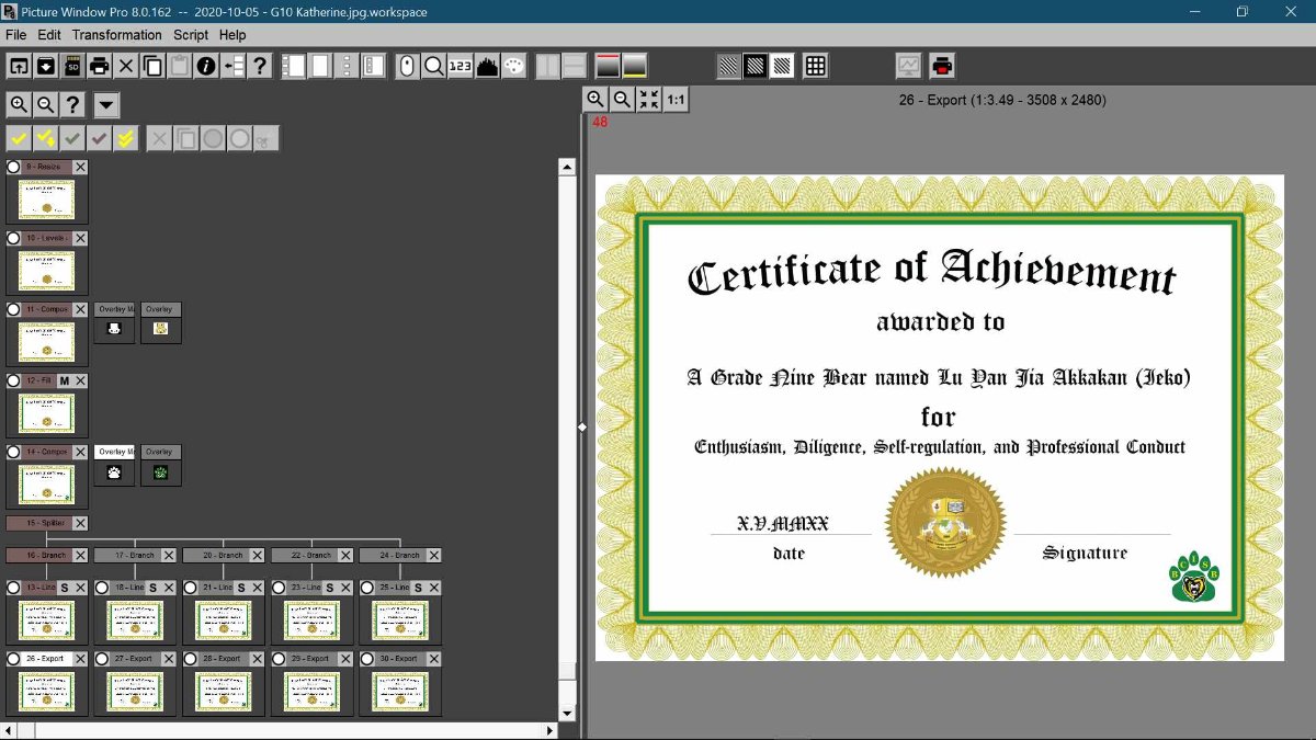

This is not related to the first question but related to the project. It boils do to processing a certificate template, compositing 2 logos into it, and then adding specific text for each recepients. So, in the and I splitted the script into 5 branches, each having each own Line and Arrow Tool (to add names and other receipient-specific text, and a date), and then I added Export to JPG.
When I ran this construct in batch mode, the Exports at the end of final branches did produced JPGs but of 10kb size and unreadable as images. However Save File, one by one from the Export Transromations produced the expected certificates in right size.

- 2020-10-06_190402.jpg (136.86 KiB) Viewed 2804 times

The Export bug was fixed in the latest release.
