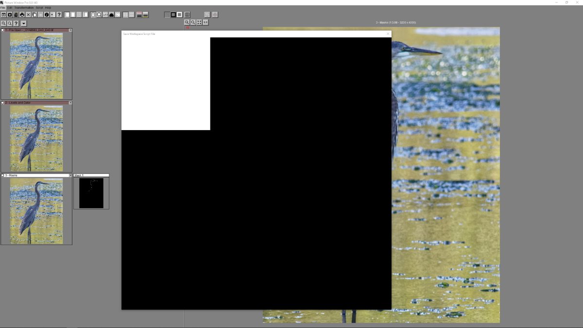

Creating a mask with many paint strokes causes the masking transform to freeze. It also prevents the workspace from being saved normally (see image).
I checked system memory usage and 3/4ish of 32gig memory was free. Attached is the zipped offending workspace file.
