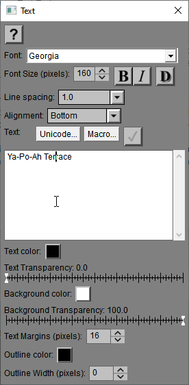

More about this transform. I prefer to have my text float on the image, which I do by making the background transparency 100%. This has the side effect of making the line origin (set to bottom) merge with the text, no matter what the text margin set value. Could the line origin be configured to honor the text margin set value, independent of the transparency setting of the text background?

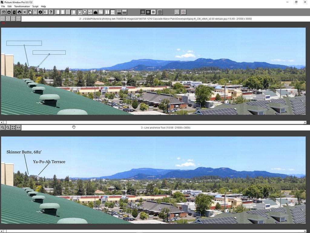

Actually, per this image, the behavior seems inconsistent. The line from the Skinner Butte label looks right. The line from the Ya-Po-Ah Terrace label is different (no gap from the text), though the Text Transform controls were the same for both labels. Suggestions for making this consistent welcome.

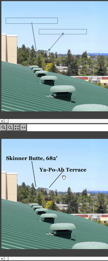

Still having issues with setting text margin...
Behaviour is definitely inconsistent:
1. Place initial text box and 2nd text box; looking good.
Image 1423.cr 50pct (Copy).png (182.13 KiB) Viewed 5524 times

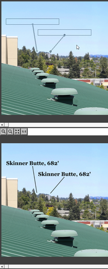

2. Update text in 2nd text box; oops, spacing is now missing.
Image 1427cr 50pct (Copy).png (186.55 KiB) Viewed 5524 times
Not sure of a sequence that will keep the desired spacing -- still looking.

If I use the text margin as you suggest, there will be problems with non-transparent backgrounds where the end of the line, if it runs at an angle, will leave a gap where it joins the text box. I believe this is why your two examples look slightly different -- the square-ended line impinges on the text to an extent that depends on the angle of the line.
What it looks like I need to do is add an extra setting which is an offset between the text and its alignment point. This would let increase the separation between the text and the line.

Yes, that would do it nicely. Though I don't see how that accounts for what I'm seeing in the example I just uploaded. The spacing is good, before I update the text. When I update the text, the spacing changes...
Re: Line, Arrow, Text Tool
Posted: August 14th, 2020, 6:51 pm
I added an offset in the Text transformation and Lines, Arrows, Text tool for the next release.
If there is still a spacing issue after this, I will try to track it down. My guess is that it has to do with the size of the text bounding box, so it you have descenders (characters that extend below the line) or characters that extend above the top of the capital letters, the bounding box changes. The text in one case includes a comma that extends the bounding box downwards slightly.
