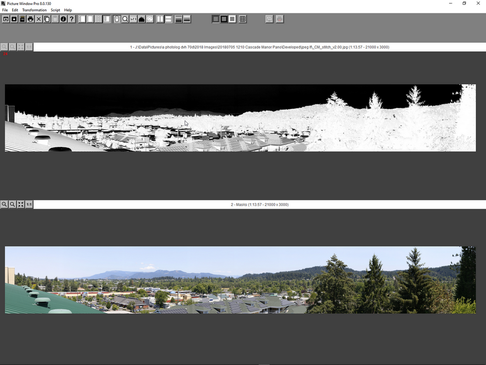

Jonathan, the vertical split works a treat, thank you! I am using a two-monitor configuration, so mask controls are on the second monitor. This is also a great feature. (Showing Mask>Separate on 2 colors transform)
My only confusion -- the top image looks like a mask, it is labeled with the source image path, the bottom image looks like a source image, it is labeled as a mask. What am I missing here?

Re: Split Screen Vertical Support
Posted: August 12th, 2020, 2:26 pm
Whatever would be on the left in a side-by-side split screen is on top in over/under split screen mode.
I am inferring from your screen shot that you have a mask dialog box open on the other monitor and that it is set to display the mask only, so the input image (which would normally be on top) is covered with an opaque copy of the mask as a black and white image.
The output of the Masks transformation is not the mask (actually there could be up to four of them) but rather an exact copy of the input image. This lets you insert a Masks transformation in the middle of a branch without disturbing it so you avoid the need for a side branch. The mask itself is available to other transformations by selecting it from the Amount menu.

Thanks, I think some time re-reading the manual section on masks might be a good idea.

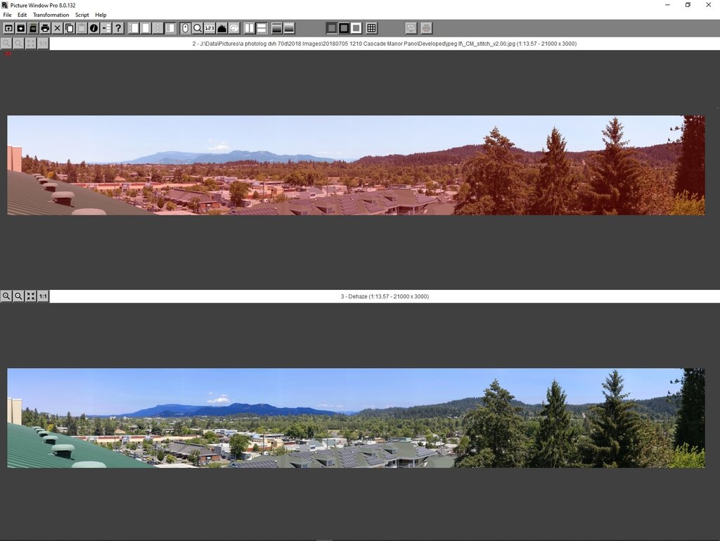

The last few sets of updates have really put the shine on a wonderful product. I was able to create the desired mask by working on it in 1/3s and then compositing the results. The action that really drove the memory occupancy up was frequent short clicks on highly detailed tree-line areas. Sweeping down the tree-line area with a good fixed-source sample gave good results without driving memory up. Tricks learned.
The app and resulting mask worked very nicely with the haze transform to produce the desired results:
Image 1419 (1024x768).jpg (104.81 KiB) Viewed 6235 times
Being able to show the images vertically makes much better use of the screen space, and is a welcome additional capability. Kudos.
The pollution haze from cities further north from Eugene is still clearly visible to the west of the Coburg Hills.
Posted: August 14th, 2020, 1:16 pm
Glad you got it to work -- each click of the flood fill tool creates two new masks, so for a large image that uses us memory quickly. The extra copies make it possible to quickly undo each step without having to start over from the beginning.
