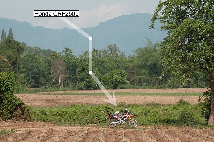

Last observation (extremely nitpicking) - I just noticed it when checking if the Macro button worked so I'll share it despite it not being really important in most cases.
If the Transparency is more than 0% and the line is Broken, not curved, the transparency of line nodes doesn't change and it remains at 0% which may make them visible as small circles on the lines, especially when the line is thick. This only affects polyline middle nodes, not the endpoints.

In the process of illustrating the previous comment, I discovered something else.
If a line has a Text box attached, clicking the OK or Apply buttons seems to close the Text control dialog box for the current line first (which in turn removes the text box) and the text box is not part of the output.
The workaround is to create a dummy point/line and move the focus to it, then hit OK/Apply.

For the next release, I fixed the out-of-bounds click and move problems and the disappearing text box problem.
The circles on semitransparent lines will be a lot harder to fix and will have to wait for a later release. The circles are there to fill in gaps between the rectangular segments of broken lines. This works OK if the lines are opaque since the overlap does not matter. To fix it I would have to render the lines opaque to a separate layer and then composite that with the output image using the transparency setting.

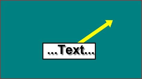

To supplement Maciej's observations and perhaps a duplication...
Ref: v8.0.114.0
If the following "*.arrow" transformation script is loaded upon a 800x450 pixel solid color image and Oked:
arrow 0 nx 800 ny 450 amount 1 -1 0 0 ″Amount: ″ ″Mask″ line_width 10.0025 head_size 4.9887 transparency 0 color ffff heads 1 style 0 line_style 0 has_text 0 text_info 0 ″...Text...″ ″Arial″ 80 4 1 0 0 ffffff 0 255 255 20 0 0 5 1 0 5.036 -45 50 10.0819 0.5043 0.3795 display 2 sync_scroll 1 auto_preview 1 narrows 1 arrow0 10.0025 4.9887 0 ffff 1 0 0 2 0.5037 0.3787 0 0 1 1 0.7955 0.7394 0 0 100 100 has_text0 0 text_info0 0 ″...Text...″ ″Arial″ 80 4 1 0 0 ffffff 0 255 255 20 0 0 5 1 0 5.036 -45 50 10.0819 0.5043 0.3795
1) the text does not re- appear until the "T" button is selected upon re-opening the transformation.
2) an OK does not close the Text Drop Shadow dialog. Arrow color (if opened); Text; and Transformation dialogs close.
3) Text does not remain centered in the text box background when a drop shadow is used. Believe the shadow transparency amount control also shifts the text background box.
Ref: v8.0.114.0

For the next release I fixed the problem of artifacts where semi-transparent line or curve segments join.
