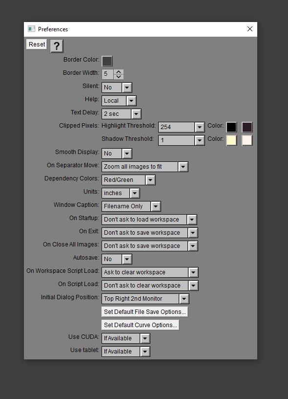

Can you send me or post a small version of the images? Do you have a proofing profile and a gamut alarm set? Also can you post a screen shot of your Preferences dialog box so I can see the settings?

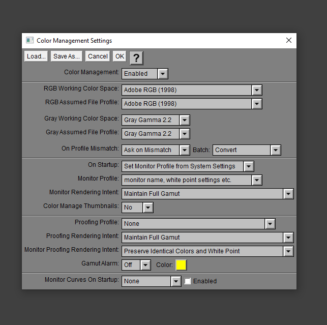

Not sure of file size limitations, so don't know if I can do this all in one post, but I will attach the image I was referencing, initially, and the screenshots of Preferences and Colour Management settings.

What's the story with your monitor profile? If you set the monitor profile Ignore System Monitor Profile Settings and then select sRGB or AdobeRGB does the problem go away?

I was largely ignoring the Monitor settings as when I recently replaced my system and moved to Win10, the monitor profiling hardware was not supported, so I am waiting until the current conditions allow me to go and purchase a compatible product.
Having said all that, I did follow your recommendations and chose AdobeRGB and all seems to be fine now. Funny though, that clicking/un-clicking the clipping button would cause this.
