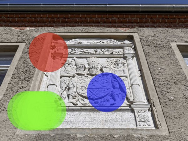

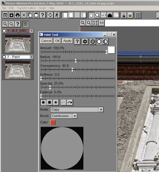

If the softness is set to 0.0 the paint is not replayed by a script.
but the result should look something like this.
K-1_3181_19_DxO v5.jpg (73.8 KiB) Viewed 2694 times
The red spot is not replayed, the blue and green are.
The difference I found out is the setting for the softness.

I think the problem is not with Softness = 0% but that the script is not replaying the paint on the first click so that if you only click once nothing is played back. Should not be too hard to fix.

This is fixed for the next release
The problem was not 0% softness or the paint color but rather that it was not replaying the first paint circle that gets applied when you click on the image. Subsequent paint circles when you drag after clicking were being replayed correctly, so if you paint by just clicking once without dragging, nothing gets replayed.
