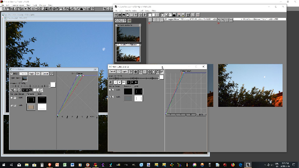

Just curious about the difference between how Color Balance in Ver 7 works compared to Multi Color Balance in Ver 8.
- color_Balance_comparison.jpg (140.07 KiB) Viewed 2408 times
Ver 7 seems to protect the highlights more so than Ver 8, but maybe there's more to it?

The difference is unintentional - other than some minor differences in how the auto black and white points are computed, I think it's a color management problem when doing the color space conversion while reading the original file.
I remember now when I was converting over the color management code that handles a mismatch between the file profile and the working color space that I noticed a bug in PWP 7 and that the conversion was being done incorrectly. I think this may account for the difference. On the other hand, the screen display from PWP 7 much more closely matches what Photoshop displays, so maybe PWP 7 was doing it right.

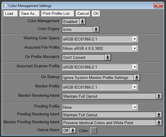

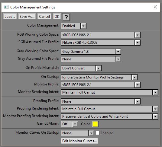

Here's the settings:
- color_management_ver8.jpg (45.66 KiB) Viewed 2368 times
- color_management_ver7.jpg (48.08 KiB) Viewed 2368 times
I've just downloaded 4-July and it appears that Ver 8 and Ver 7 results now look pretty similar. I'll try a few test images and report if I find anything interesting...
