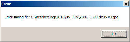

Sometimes I get the following error message during saving an images:
If I switch off the saving ot the script the save works.

Unfortunately, it seems the WIC JPEG encoder does cannot handle the large amount of metadata of long scripts. Consequently, I have removed the option of saving embedded scripts in JPEG files, at least for now. Embedded scripts in TIFF files are still OK.

There were about 6 steps, but the cloning step had a lot of coordinates tracking each cursor move so the script was about 22kb.
