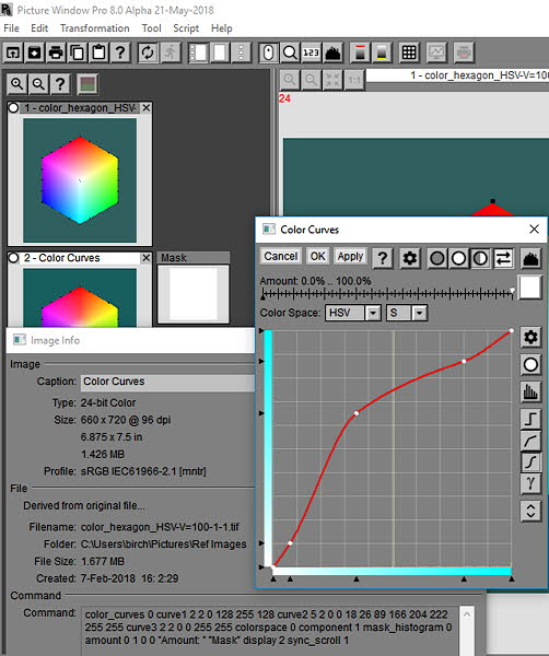

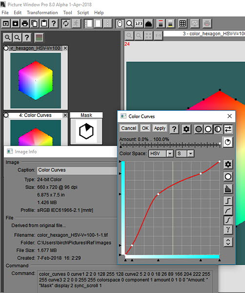

...in any case PWP 8.0.exe 180521 does not properly execute the Amount Mask portion of the following script with *.script or *.workspace extension but PWP 8.0.exe 180401 [arbitrarily selected for test purposes] will as a *.script file...

Screenshot PWP 8.0.exe 180401:
Screenshot (2).jpg (202.2 KiB) Viewed 2926 times
Screenshot PWP 8.0.exe 180521:
Screenshot (3).jpg (199.58 KiB) Viewed 2926 times

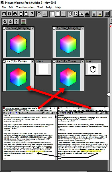

Jonathan... ...apologies:
Please disregard this whole thread.
I was able generate a proper script mask with PWP 8.0.exe 180521 by updating the script as illustrated in the following illustrations: the left browser tree is the script posted above and the right browser tree is using an updated script. The highlighted script text is the difference between the old (on the right) and the new properly working script text (on the left)...

The revised working 180521 script:
