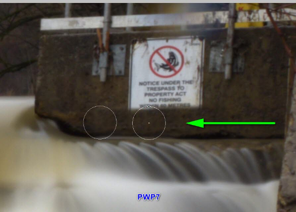

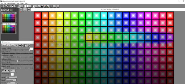

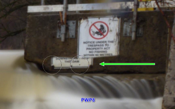

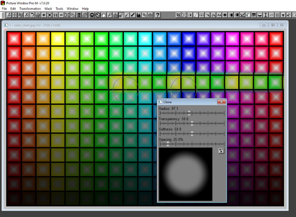

I notice different behaviour when cloning in PWP8 from PWP7. Make a selection, then click+hold to paint the selection over a wider area. In PWP7, the selection picks up the "new" pixels, while PWP8 picks up the "old" pixels... Here's some pictures to illustrate:
PWP7
PWP8
I'd prefer the way PWP7 handles it, but I'm wondering if the change was deliberate?

In PWP8, when cloning an image onto itself, pixels are taken from the results of the previous strokes instead of from the current image. This avoids the problem of overlapping source and target areas causing the same part of the image to be repeated over and over as you drag the tool, which is seldom a desirable effect. As long as the source and target areas do not overlap, PWP8 should be the same as PWP7.
