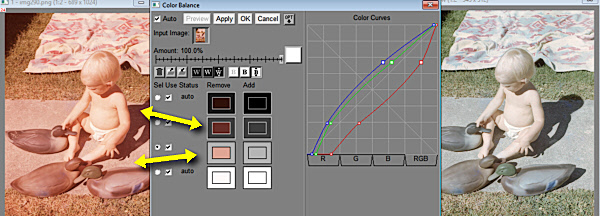

Fortunately, this image has the sidewalk from which to select neutral grays near 25 and 75 % tones using the shadow and sunlight image areas... ...not always so convenient sampling!!!
Step 1: use the Color Balance transform to establish neutral black and white full range points with neutral grays near 25 and 75 % tones:

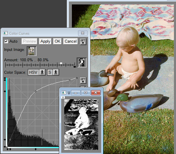

Step 2: Apply a 'Vibrance_Skin-Hue_Mask" [see the TIPs message board section] to the resulting Step 1 image and use a HSV-S Color Curves adjusting the Input Mask black/white sliders, and HSV-S curve Control Points to a preference while monitoring an updating Preview:

The main issue with this kind of images is the different fading of the different colol chanals.
A quite and dirty approach may be to convert the image in a first step to a negativ one (with the Gray|Negative Transformation).
Then use the Color|Negativ Transformation to convert it to a positiv again. With this fransformation you have an easy access to the gamma of the different color curves. So the curves can be adjusted differently. As you see in den's workflow: Red needs obviously to be adjusted different than the other curves. Some finetuning with the color balance and the saturation transformation will finish the result.
Doubtless there are different valid workflows for this problem. The main problem is that you have to adjust the color curves separately since the fading is different.

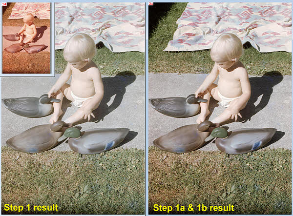

Addendum to the Step 1 Color Balance transform workflow...
Notice the rather extreme correction made to remove the red color cast from the full range black point. In these cases where neutralizing color casts at the black and white points, it may be better to do this as a separate step first and then remove color casts of the mid-tones of the resulting image... i.e.,
Step 1a Click on the starting image and open the Color Balance transform with default settings to remove color casts from the black and white full range points; Click Apply.
Step 1b Change the Input image to the resulting Step 1a image; select OPTions-Reset; now sample the sidewalk shadow and sunlight image areas to remove mid-tone color casts; and click OK.
